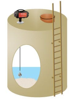

BinMaster Level Controls recently announced the SmartBob-SS sensor, which is specially designed to measure submersed solids under water. The SmartBob2-SS sensor option is a proven solution for brine interface applications, when the requirement is to measure the level of solid material below a liquid surface, such as measuring the level of settled salt under water. SmartBob SS is just one of various sensor options that can be used in conjunction with the SmartBob weight and cable inventory measurement system.
The SmartBob-SS sensor drops a weighted Bob through the liquid; when the Bob comes into contact with solid settled material at the bottom of the tank, it retracts and sends a measurement to a SmartBob control console or a PC loaded with eBob software. The SmartBob-SS sensor’s special design comes configured with a 3-inch standpipe for ease of installation, a stainless steel cable that stands up to corrosive materials, and a SureDrop cap that prevents the weight from being retracted into the pipe and protects the device from unwanted material entering through the standpipe.
